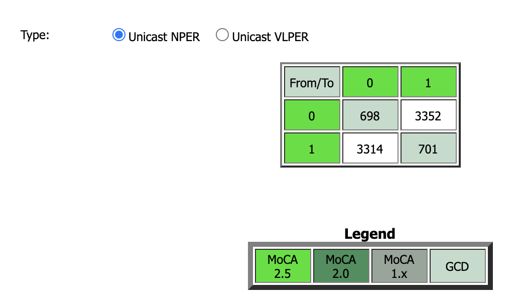

I was able to get two devices (WF-803M) connected and ideally want to run one to a new mesh unit with wired/Moca backhaul. Everything seems to be working at first until the signal will randomly die. This was causing major issues for my mesh point (Synology) and eventually I tried just plugging in another computer directly... Again it is working great until it randomly disconnects a few hours later and needs to be reset to re-establish connection. Is there anything that I can try to debug this issue? It has been incredibly frustrating. I just swapped this: https://www.amazon.com/gp/product/B00CUIUOWO/ref=ppx_yo_dt_b_search_asin_title?ie=UTF8&psc=1 For this: https://www.amazon.com/gp/product/B07TV2LZCP/ref=ppx_yo_dt_b_search_asin_title?ie=UTF8&psc=1 Which I am guessing should help? Here's my link status for the two devices in the admin:
