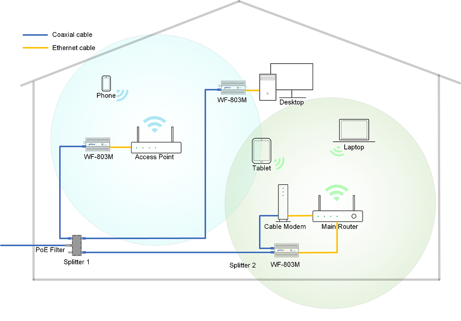

Network diagram
Based on different ISPs, our products can support many network diagram.
Cable ISP, the upper frequency of cable modem is 1002MHz. We know many customers are using cable ISP, such as Comcast, Spectrum, Cox and others. Because the cable Internet(DOCSIS3.0 or DOCSIS3.1) will share the same coaxial network with MoCA, so the most important part, please double check the upper frequency of your cable modem. You can check it from this link. https://www.cablelabs.com/certification. Please check the 'DS Freq Range' column of 'Certified and Qualified Devices'. Make sure the upper frequency is 1002MHz. MoCA is using 1125-1675MHz. They can work together.
Cable ISP, the upper frequency of cable modem is 1218MHz. Some DOCSIS3.1 modems have a higher upper frequency, such as ARRI1263. Please install a 2-way splitter to connect MoCA adapter and cable modem. And just before the cable modem, please install a PoE filter to separate DOCSIS and MoCA signals in the same coaxial network.
Fiber ISP and others. In such situation, you have an Ethernet cable connected to your main router, to provide the Internet Access. Only MoCA is using the coaxial network. It is much easier.
Notes
Please double check the Splitters. First, all of them should be MoCA compatible. They should can pass the MoCA signal band, 1125-1675MHz. For Splitter 1, please make sure the coaxial cables from different rooms should be connected to it. Otherwise, the MoCA adapters can't 'see' each other and the MoCA link is down(MoCA light is OFF).
